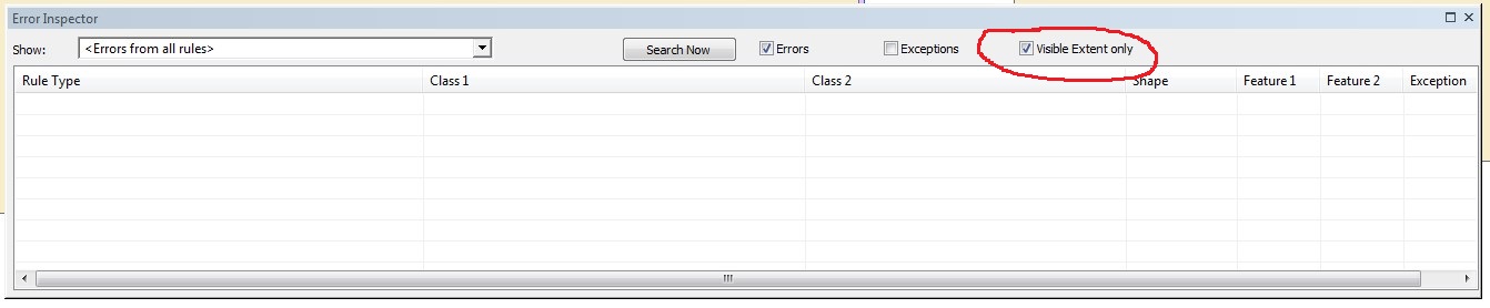

As Neil Ayres alluded to, one can create a topology on the whole dataset, then in the Error Inspector window check on the box for Visible Extent only.  Zoom to the extent of what you want to work on and then click the "Search Now" button to see what issues are present in that area.  You can bookmark the locations to make it easier to get to each extent that needs review.
