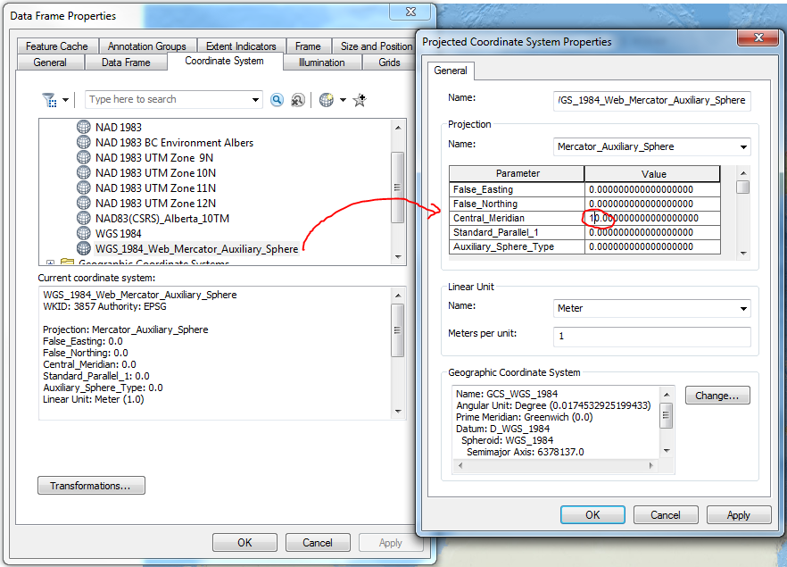

Just to expand on Melita Kennedy​'s comment, you can shift the CRS over by changing the central meridian parameter and saving as a custom projection, in the Data Frame Properties.

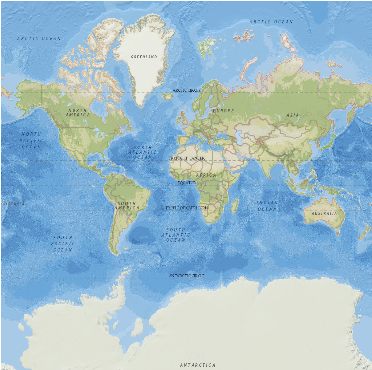

Original (using Web Mercator, but you can change any CRS):
Change CRS in Data Frame Properties:
