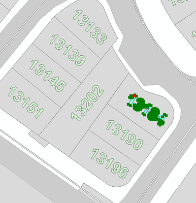

Hello all,
This is a bit puzzling label related question. I need to add/modify the parcel numbers. The only glitch the labels are actually individual polygons (and they are stored as polygon data layer):

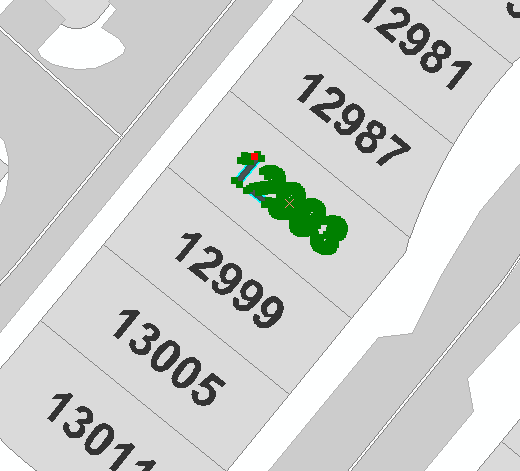

When you delete one vertex from the label (like the one above) the entire label (or polygon) is gone.

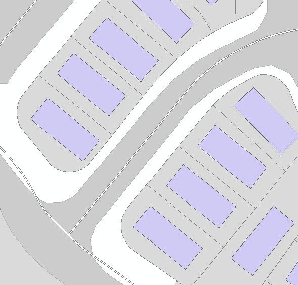

I have been scratching my head on how to add these labels. When I want to add a label, it's literally adding a polygon (see below in red):

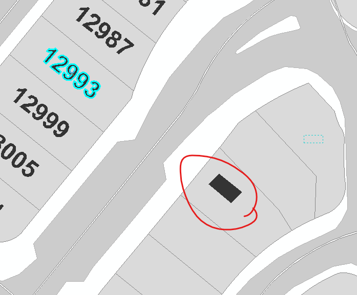

I am guessing a person who created these 'labels' must of somehow converted annotation to these individual polygons. I did try to convert annotation to polygon but then it just creates polygon around the entire label:
It doesn't outline the numbers.

So I was able to answer my own question.
It's 'Feature Outline Mask' tool that converts annotation to outlined polygon annotation:
