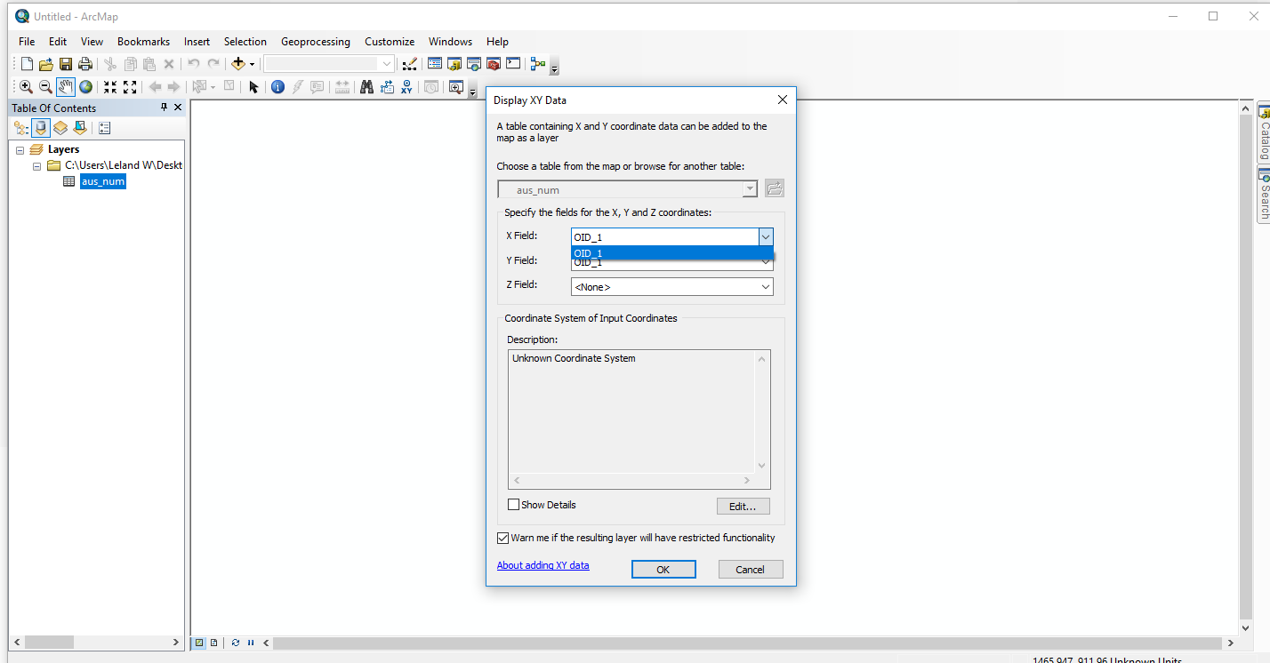

I have a series of datafiles of all place names within several different countries saved as .dbfs that I'd like to display in ArcMap. Each row contains an ID as well as a latitude and longitude value; however, whenever I attempt the conversion ArcMap doesn't allow me to select the corresponding lat/long columns within the 'Display X,Y Data' action window. I've attached one of the relevant .dbfs and a screenshot of the issue to assist anyone who may understand this issue better than I.

Hi, Mike.
I took a quick look and you need to change your 'data type" form "text" to, say, "Double". All else looks OK.
You can create a shapefile from your corrected table in ArcCatalog. . . right click/create feature class from x-y data. Make the coordinate system WGS84 when your lat/long is in decimal degrees.

I converted the dbf to an Excel file and changed the data type from "text" to "number" for the relevant LAT and LONG columns. However, when I attempt to perform the 'Display X Y Data' operation, I'm now only given the option of using the ID field (see picture). This remains true whether I add the data as an Excel doc or as a dbf. I have no clue what might be causing this issue, but would definitely like to rectify it. Thanks so much!
JosephCarter
Mike, you are getting close. I advised using "Double" for the data type. Try that.
