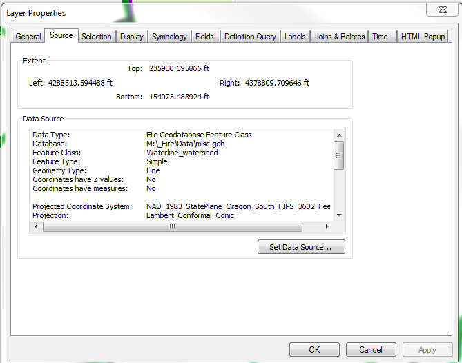

Kay,
A red Exclamation mark indicates that a layer cannot be mapped.
Yes there is a few ways. One way is to open the layer properties.
Go to the source tab.
Click the Set Data Source button.
Find where the layer is located.

right click on a lost layer
select Data repair data
navigate to the location where the data is located
If you can find it ... and all other data reside in the same location all broken links should be repaired.
if they are repaired, select map document properties, and toggle on the save relative paths checkbox

As Rickey mentioned, a red exclamation next to a layer means the link to the data has been broken.
You can often relink the data right in ArcMap by clicking on the exclamation point, then browsing to where the data is.
Repairing Broken Data Links
