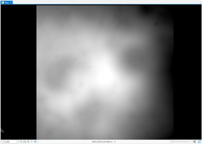

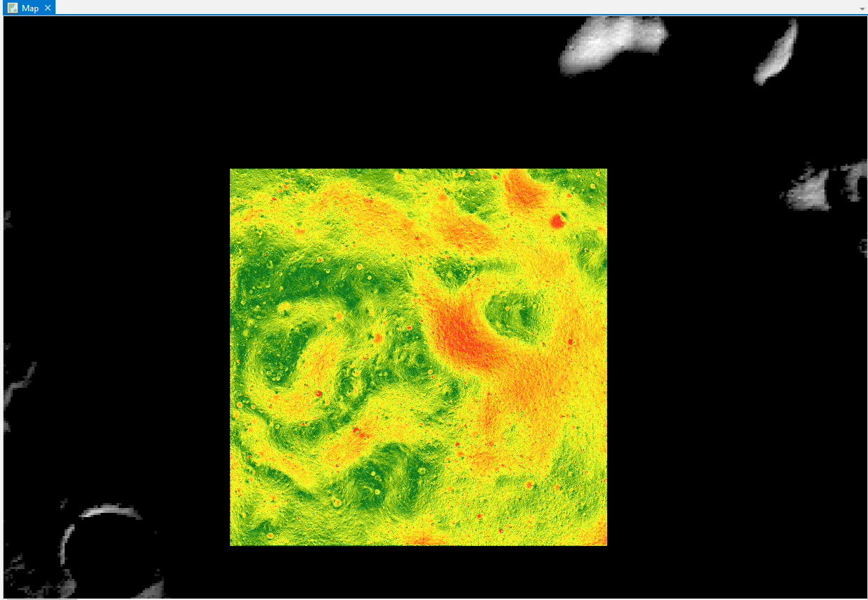

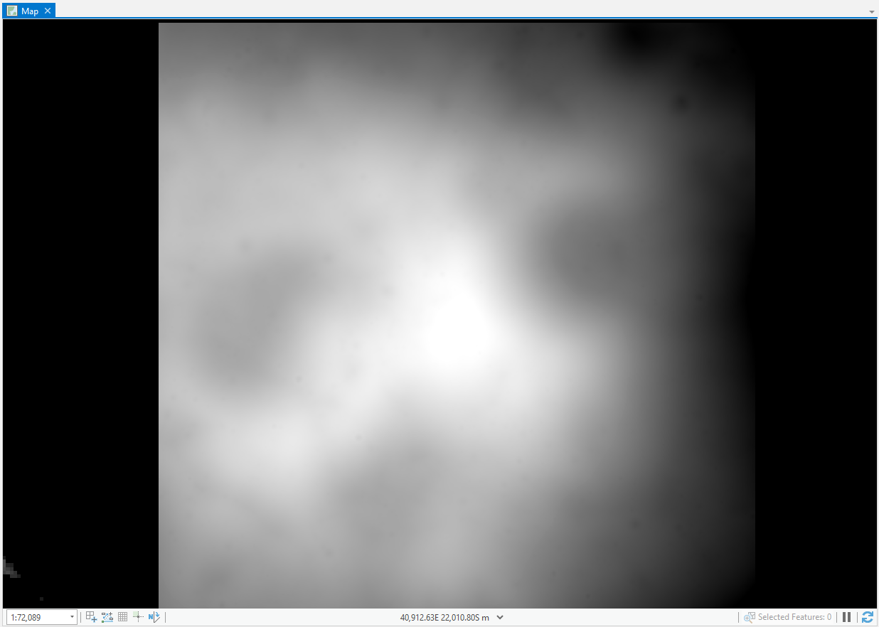

I am attempting to display a DEM of Slater Crater on the Lunar South Pole. However, the DEM does not display correctly despite having the same extent and spatial reference as the other data.
The DEM displays when it's viewed at a different zoom level and then disappears as seen in the screenshots below:
Any clue as to what's causing the DEM to display incorrectly?

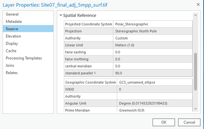

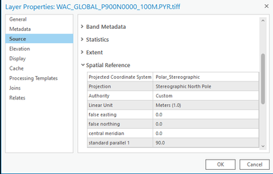

The spatial information is as follows:
I've used the "define projection tool" to project the DEM to be the same as a polar base map.
Base Map Projection:
DEM Projection:
