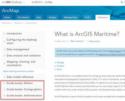

If you are looking for paper chart production documentation, then we have several guidebooks. They are located at: https://desktop.arcgis.com/en/arcmap/latest/extensions/maritime-charting/what-is-the-arcgis-for-mari...
