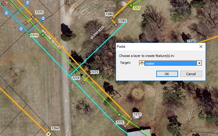

Trying to copy selected features from one layer and paste into another layer.  When doing this, i follow the proper steps: 1. go in edit mode of item trying to copy. 2. select features i wish to copy. 3. click the copy button. 4. click the paste button.  At this point the only layer i am able to copy to is the same layer that i'm in.  I have many more layers available with my map, why am i unable to select a different layer.  My coordinate zones match and there is no errors occurring.  see attached...
trying to add some data that i exported as a .shp from Civil 3d and add it to my water main layer in arc-map.  this is the only layer that is available and that is the layer i brought it in on from civil 3d, i need to copy to my Water Mains layer.
THANKS IN ADVANCE

The file that i'm trying to copy over is a shape file.  The layer I'm copying to is a geodatabase.  Not sure if they are in the same editing work space, i believe yes.  I'm pretty new to this stuff.  I'm trying to just streamline importing as-built data.  We currently bring in a .dwg and trace over the line work.  I  thought creating a shape-file from that line work, bringing it into arc map and copying it to the correct layer would be a lot faster... that is if i could figure out how to copy it over.
I tried it both ways, with that as the only selectable layer and not.  Going from Water 2 (at top) trying to copy to Water Mains (the red one)
