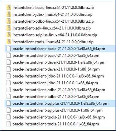

  • Install Oracle Instant Client for Linux
Instant Client for Linux x86-64 (64-bit) (oracle.com)
  • use the RPMs to install, avoid the .ZIP
*OCI – Oracle Call Interface API
“basic” – all files required to run OCI, OCCI, and JDBC-OCI applications
“sqlplus” – SQL Plus command line tool for SQL and PL/SQL queries
“tools” – Data Pump, SQL Loader, Workload Replay tools
“jdbc” – additional support for internationalization under JDBC
“odbc” – additional libraries for enabling ODBC applications
“devel” – additional header files and example makefile for developing Oracle applications with Instant Client
  • The RPMs package installs the files under /usr/lib/oracle/21/client64
  • You need to install only the RPMs for “basic” and “sqlplus
# su – root
# yum install oracle-instantclient-basic-21.11.0.0.0-1.el8.x86_64.rpm
# yum install oracle-instantclient-sqlplus-21.11.0.0.0-1.el8.x86_64.rpm
  • There is no need to install any of the other RPMs like “tools”, “jdbc”, “odbc”, “devel”
  • the RPM “basic” will create the folder “lib” under /usr/lib/oracle/21/client64
  • the RPM “sqlplus” will create the folder “bin” under /usr/lib/oracle/21/client64
  • Oracle Instant Client Directory is /usr/lib/oracle/21/client64
  • lib” folder contains the OCI API libraries
  • bin” folder contains utilities like “sqlplus”
