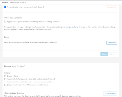

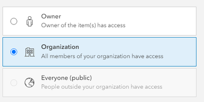

I am trying to share a hosted map, web map, and web app with "everyone". The problem, that option is "greyed" out on the main host layer. I've tried everything, and am still unable to enable this option.
Here are my "settings" for the hosted layer:
I cannot share my web map, that is pointed in my web app without that option to share wih everybody. Has anyone ran into this issue that might have a solution?

We recently disabled the ability to share certain hosted data services with the public for Developer accounts only. With the Data hosting feature of ArcGIS Platform coming out of beta on November 1st, usage is now metered on all hosted data services owned by Developer accounts only. In order to share any of your data with the public you must provide authentication to the service in the form of an API key or other authentication method. Please review the documentation at Data hosting as well as the manage sharing and security section.

Did you tick the box for public data collection?
(however, if you have editing enabled on this dataset in theory anyone could edit your data.)
