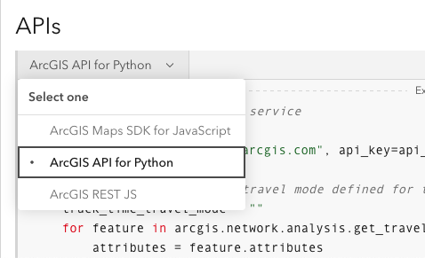

@QassimNasirReview the material on this page https://developers.arcgis.com/documentation/mapping-apis-and-services/routing/optimized-routing/ and select ArcGIS API for Python in the code switchers to see the Python code.

Unforuntely, I find only those
ArcGIS Maps SDK for Kotlin
ArcGIS Maps SDK for Swift
ArcGIS Maps SDK for .NET
ArcGIS Maps SDK for Qt
I could not find Python in there.
QassimNasir
Thank you so much. That code can be used for Enterprise as well?

Hi @QassimNasir , the code I referred you to cannot be used with ArcGIS Enterprise because API keys are not supported. In that case you should use username and password when creating portal.
portal = arcgis.GIS("https://www.arcgis.com", username="<USERNAME>", password="<PASSWORD>")
