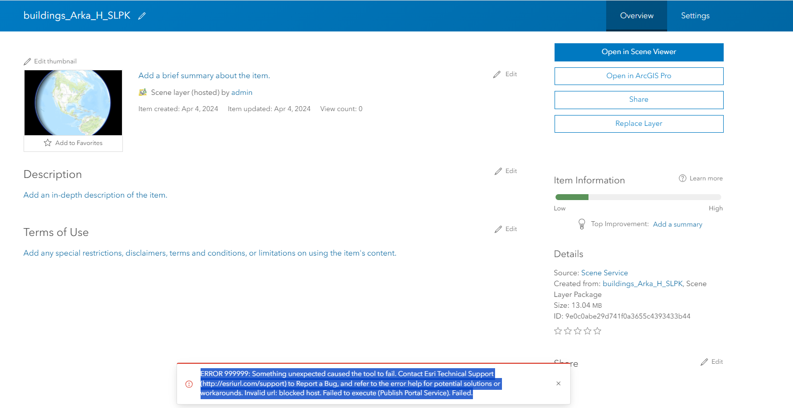

Adding it via Portal as a new Portal Item. It  asks me if I want also to Publish Scene Layer, I confirm and 2 Portal Items are created, but Scene Layer is created with ERROR 999999, and therefore is not working, I can´´t add it to a Web Scene
Full Error:
ERROR 999999: Something unexpected caused the tool to fail. Contact Esri Technical Support (http://esriurl.com/support) to Report a Bug, and refer to the error help for potential solutions or workarounds. Invalid url: blocked host. Failed to execute (Publish Portal Service). Failed.

So I tried to publish the Scene package to a different Portal instance and it worked.
Strangely, I am able to publish the SLPK and create a Scene Layer in an older instance of AE Server (10.8.1) and Portal (10.8.1 (build 14362)), but not to a newer AE 11 version instance - Server (11.2.0 (build 49116)) and Portal (11.2). In the 11.2 I still get the ERROR 999999.
I kind of need everything to be in the same AE instance.
