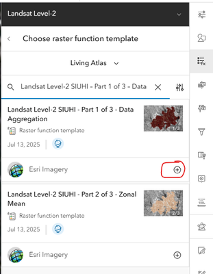

I am trying to follow the steps on the blog entry on mapping urban heat islands. When I try to select the Landsat Level-2 SIUHI - Part 1 of 3 - Data Aggregation raster function template (Step #4) , it gives the following error:
Any help would be appreciated.
Thanks!

dsinha
@RWaterman I get that error message when I try to add the RFT to the map. The Map Viewer interface looks different for me than it does on the tutorial, so not sure if I am doing something wrong.
Thanks!

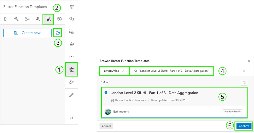

RWaterman
I see. As noted in the tutorial, you will need to add the RFT from within the analysis tools (you are trying to add via the "Processing Templates"). See the graphic below from the blog article, which notes selecting the "Analysis" option as step 4.1. From there you will navigate to the Raster Function Templates Option and add the RFT.

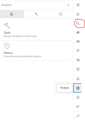

dsinha
The AGOL analysis panel looks different from the one shown in the tutorial. Not sure why - I thought AGOL was same for all.
The Processing Template does not appear in the Analysis panel but on the side panel.
RWaterman

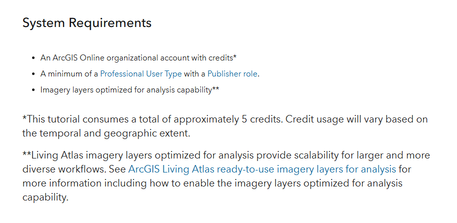

It seems you may not have the appropriate permissions to perform raster analysis in ArcGIS Online. The first section of the tutorial is system requirements. The second bullet pertains to individual user permissions. The third pertains to enablement of "imagery layers optimized for analysis" which enables scaled raster analysis against designated Living Atlas imagery layers. Both will require you to check with your system admin for appropriate permissions/enablement.
https://www.esri.com/arcgis-blog/products/arcgis-living-atlas/imagery/learn-to-map-urban-heat-with-l... SIUHI system requirements.png
dsinha
Thanks for your help @RWaterman. I did see those requirements. I am the admin for my organization. So I have all the user privileges and the credits required for this workflow. I am registering a case with Tech Support to see if I might have missed something. I will report back here when I hear from them.
