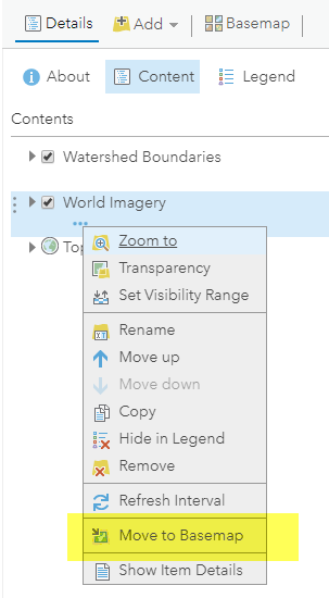

Option 2 - moving the layer into the basemap
You can use the 3 horizontal blue dots (More Options) under the layer name and select Move to Basemap.
This moves imagery into the basemap layer (expand the layer by the small black triangle)
You can delete the Topographic layer if not needed through the More Options dots of the Topographic layer and select "Remove".

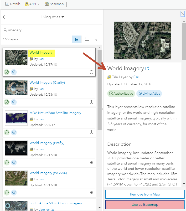

Option 3 - adding the layer as the basemap
If you really do want the Imagery layer to be the base layer (i.e. basemap) of your web map, when you are adding the Imagery layer to your project, click on the title of the layer (highlighted yellow below) and the details of the item will appear to the right.  At the bottom of the details, there's a button for:  Use as Basemap.  Click to replace the existing basemap with World Imagery (in this example).  It will keep your operational layers intact, above the base layer.
Notice, it also changes the name of the basemap layer, since World Imagery was set as our basemap, not just moved into the basemap layer like the other instruction above.
