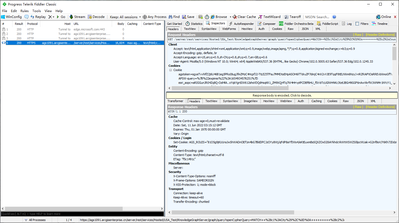

Most likely, the streaming is not working in this deployment. Do you see a response header called "Transfer-Encoding:chunked" when you capture the request from Pro in Fiddler?
xingchenc
Hi Mandar,
Please see the screenshot attached. I did not see the "Transfer-Encoding:chunked" message.
MandarPurohit
Ok, looks like Pro is timing out when the query is sent to the server, and it's running on the database.  How does the fiddler query show when you capture it from the browser (from the same Pro machine) ?

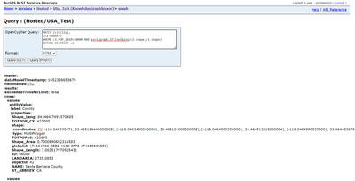

Are you suggesting running the Cypher query directly from the REST API?
Please see the screenshots below for the test result.
As you can see, the REST API has returned the result without interruption (although very slow), and then in the fiddler screenshot you can see the request is completed.
