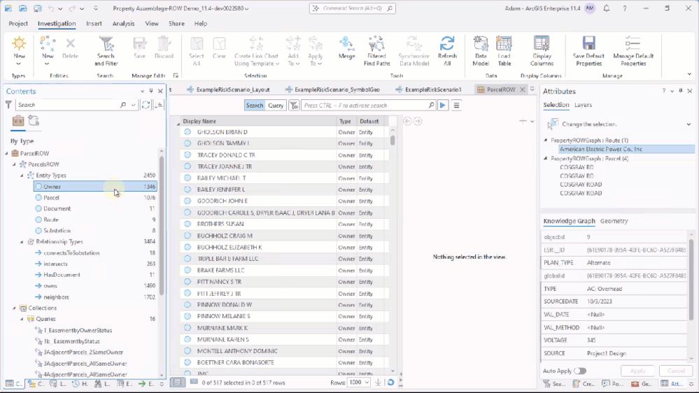

AdamMartin
Status changed to: Implemented
Thanks @xingchenc  for the comment. We heard this from a lot of folks, and luckily have addressed this in Pro 3.4 which is already released. I hope you are able to access this latest version soon.
In the Investigation view, you can right click on then Entity or Relationships Type, Choose Properties, and then select a different Property to be your Display Name. You can also use an Arcade Expression to customize further.
See the example quick example below and let us know if you have more questions or enhancement ideas.
