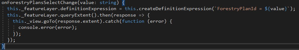

I created logic by this example in my Angular 8 app:
Zoom to extent of all features | ArcGIS API for JavaScript 4.15

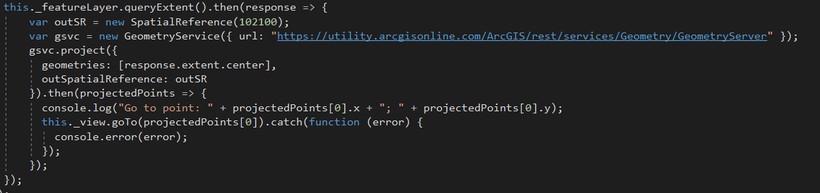

But in method the method goTo throws exception: Cannot read property 'targetGeometry' of null. I can't understand the reason of exception. I found some solution to move scene to point and it works:
But I would like to use view.goTo(response.extent) it is more native and clear.
One more thing: coordinates in sweref 99 format. Could it be a reason of the  issue?

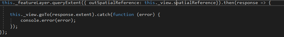

The geometry that you are zooming to needs to be in the same spatial reference as the view. In your queryExtent you can provide a query class and set the outSpatialReference to the view.spatialReference.

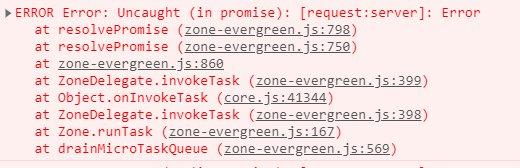

But I got another error:

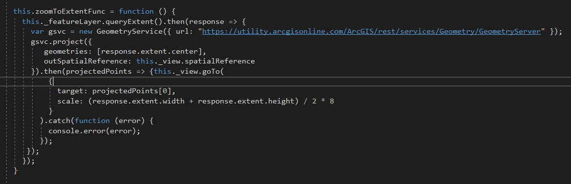

Difficult to understand the reason. I found temporary solution with zoom. It is not so clear but works quite well. Coefficient 8 is selected approximately   Maybe this will help someone.

The issue with your
this._featureLayer.queryExtent({outSpatialReference: this._view.spatialReference}).then
is that you are passing a simple Object and not an actual Query Class.
