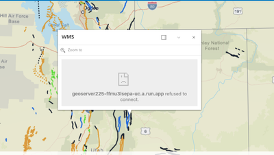

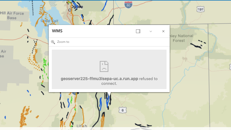

Hi all,
Minimum example: https://codepen.io/clintonlunn/pen/eYweyzj?editors=1001
I am trying to troubleshoot why I cannot get a popup working when I am pulling a WMS layer from Geoserver. When I click, the popup shows, but only an error message is populated. The console shows: "Refused to display 'https://geoserver225-ffmu3lsepa-uc.a.run.app/' in a frame because it set 'X-Frame-Options' to 'sameorigin'."
When I copy the request into my api client tool (https://www.usebruno.com/), I get the data back that I expect.
See working curl request below:
curl 'https://geoserver225-ffmu3lsepa-uc.a.run.app/geoserver/public/ows?bbox=-13716921.203505095%2C3336548...' \

ClintonLunnUGS
I seem to have answered my own question. For me, the key is to use the fetchFeatureInfoFunction function, and make a custom popup template there. I'm not sure if there's a better way to do this, definitely open to suggestions.
In addition, I am not sure how long this wms source will be active for (this is a dev server that we are test driving Geoserver on). I will try to swap it out with another WMS layer that hopefully won't go away.
