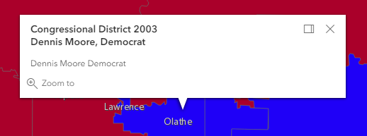

When I simply click on the feature, I get this (correct):
Popup with correct content

Brandon,
   You have to be careful as JS is a case sensitive language. You had:
      var congress = new FeatureLayer({
            url: "https://services.arcgis.com/V6ZHFr6zdgNZuVG0/arcgis/rest/services/CongressionalDistricts/FeatureServ...",
            popupTemplate: { // autocasts as new PopupTemplate()
              title: "Congressional District {DISTRICTID} </br>{NAME}, {PARTY}",
              content: "{Name} {Party}",
              overwriteActions: true
Which should have been:
              content: "{NAME} {PARTY}",
Notice field names are upper case in the content property now.

BrandonFlessner
Excellent! I knew it must be something silly. Thanks Robert
