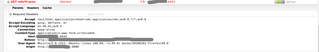

I am trying to read the metadata of published FeatureService from ArcGIS server using esri/request AMD module.
Its working fine on chrome and is returning the list of metadata and layers to read from which i use later to add them on my map.
But surprisingly, the same is failing on Firefox. Here is the net panel screenshot for the request,
The code for request is simple, as following
