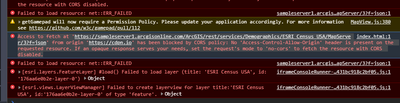

Try with this ms. https://sampleserver6.arcgisonline.com/arcgis/rest/services/USA/MapServer/3 works for me.
These are the errors I get in my console log if I try your ms.
