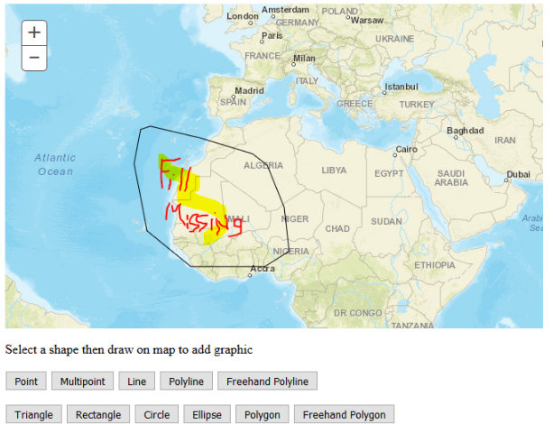

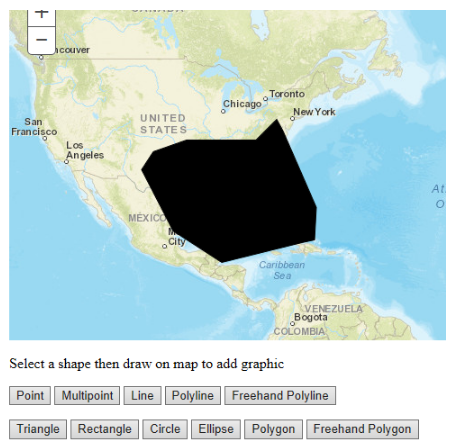

In MS Edge, Safari on Mac and iOS the fill is solid black (no hatch or picture).
In FireFox on Windows & Mac the fill is completely empty (no hatch or picture).

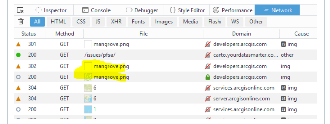

  • The network tab shows the fill picture (hatches in simplefillsymbol use a picture just like a picture fill symbol) IS being downloaded successfully.

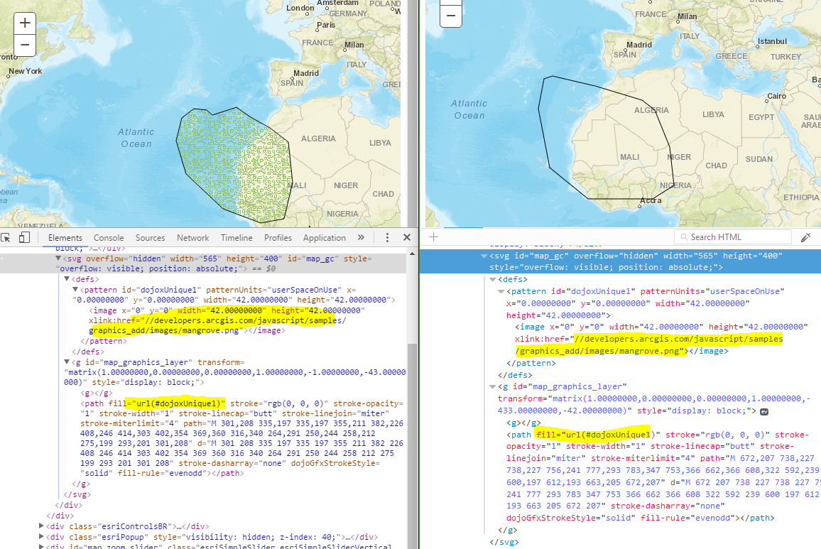

  • Inspecting the canvas svg elements and the sections in the working and non-working browsers show the exact same information so the svg elements appear to be correctly created.

FireFox result:
FireFox network trace (image is downloaded, other browsers show same download success)
MS Edge and Safari result
Comparing SVG in element inspector Chrome (left) v FireFox (right)

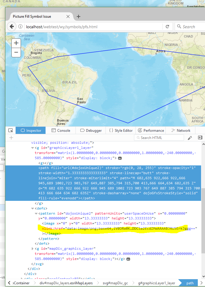

I tried a data uri for the image url, works fine in Chrome, still fails in FireFox:
