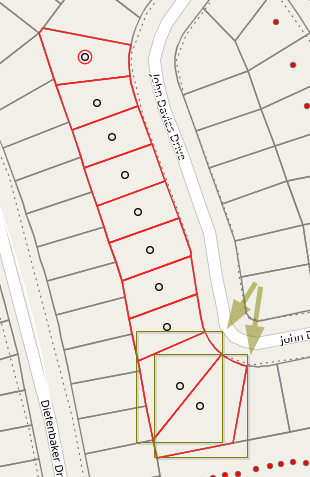

I have this pice of code:
parcels.forEach(parcel => {
const centroid = parcel.geometry.getCentroid(); //getExtent().getCenter(); //getCentroid();
const feature = new Graphic(centroid, myUtils.NEW_ADDRESS_SYMBOL);
this.map.graphics.add(feature);
and I'm getting this result:
The centroids are not in center of parcels, and some are outside their parcels.

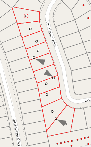

There is no point in publishing all code (I can do that on request), but changing this line:
const centroid = parcel.geometry.getExtent().getCenter(); //getCentroid();
for ilustrating the center of the extent of the parcel instead of the centroid give better results:
Note that this is not a good solution:
I have added the extent for the last two parcels to show that the centre of the extent is not the desired solution, but this is a lot better solution that the getCentroid function the way I got it.

When running the “get Centroid” button there is a 50/50 chance to get a(n almost) correct centroid, so, give it a chance: inspect more than one parcel…

I would argue it is clearly a defect with the JavaScript API, and unfortunately it still persists in the 4.x series.
Looking at one of the "problem" parcels closer, ObjectID 12447, ArcGIS API for JavaScript gives a centroid of (-8986321.196204321, 5333925.59120203).  Calling the REST API for information on the parcel, a centroid is returned of (-8986332.9944987688, 5333932.5941599887).  Using the Esri JSON coordinates returned from the REST API and loading them into ArcGIS Pro, ArcPy returns a centroid of (-8986332.994498769, 5333932.5941599915).
