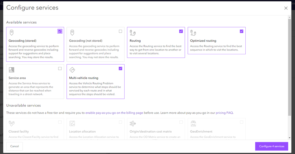

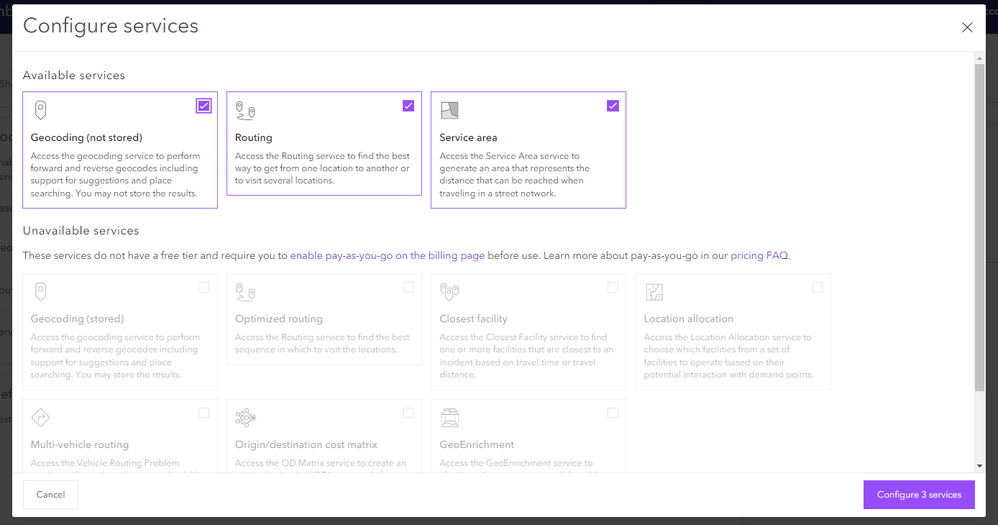

I think I might have figured it out. My API key was created back in October when Multivehicle routing was still a part of the free tier.
I just tried to create a new API key and it doesn't allow those options anymore. I think ESRI might need to
make a note on those API keys created before the change.
See the two screenshots.
Created March 2022Created March 2022Created October 2021Created October 2021
