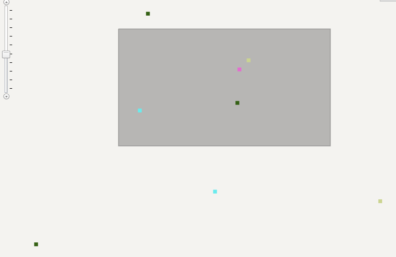

Referring to this topic, I can search the result within a drawn polygon, however it requires me to set a template for returned result:
var symbol = new SimpleMarkerSymbol(
  SimpleMarkerSymbol.STYLE_CIRCLE,
  12,
  new SimpleLineSymbol(
  SimpleLineSymbol.STYLE_NULL,
  new Color([247, 34, 101, 0.9]),
  new Color([207, 34, 171, 0.5])
featureLayer.setSelectionSymbol(symbol);
It works fine, but I want to make every returned records have its own color which is determined by its attributes value, i.e. blue color represents cars, yellow represents building, etc...
featureLayer.queryFeatures(query, function (featureSet) {
  var inBuffer = [];
  var renderer = new ClassBreaksRenderer(null, "category_id");
  renderer.setMaxInclusive(true);
  var categoryColorList = [];
  var inBuffer = [];
  for (var i = 0; i < featureSet.features.length; i++) {
  if (featureSet.features.geometry == null)
  continue;
  inBuffer.push(featureSet.features.attributes[featureLayer.objectIdField]);
  var rcolor = new Color([Math.floor((Math.random() * 255) + 1), Math.floor((Math.random() * 255) + 1), Math.floor((Math.random() * 255) + 1)]);
  if (typeof eval("categoryColorList._" + featureSet.features.attributes.category_id)
  == "undefined") {
  eval("categoryColorList._" + featureSet.features.attributes.category_id + " = rcolor");
  var symbol = new SimpleMarkerSymbol({
  "color": eval("categoryColorList._" + featureSet.features.attributes.category_id),
  "size": 5,
  "angle": 0,
  "xoffset": 0,
  "yoffset": 0,
  "type": "esriSMS",
  "style": "esriSMSSquare",
  "outline": { "color": eval("categoryColorList._" + featureSet.features.attributes.category_id), "width": 1, "type": "esriSLS", "style": "esriSLSSolid" }
  renderer.addBreak({
  field: "category_id",
  minValue: featureSet.features.attributes.category_id,
  maxValue: featureSet.features.attributes.category_id,
  symbol: symbol
  query = new Query();
  query.objectIds = inBuffer;
  (function (featureLayer) {
  featureLayer.selectFeatures(query, esri.layers.FeatureLayer.SELECTION_NEW, function (results) {
  featureLayer.refresh();
  })(featureLayer);
Although within the polygon, the results are returned, the related records outside the polygon are also being shown. I was wondering if someone could let me know if there are something else that I should care about. I am not going to use graphic layer to store the returned result because I want to keep things simple, with only 1 feature layer, thanks you.

   That sample uses a Featurelayer that is already drawing ALL the layers feature and then just selecting the features that intersect the buffer and applies a symbol to the selected features. The way That I suggest that you go is to change the FeatureLayer to MODE_SELECTION that way none of the feature show until your buffer is done and then all your other code will be fine.
