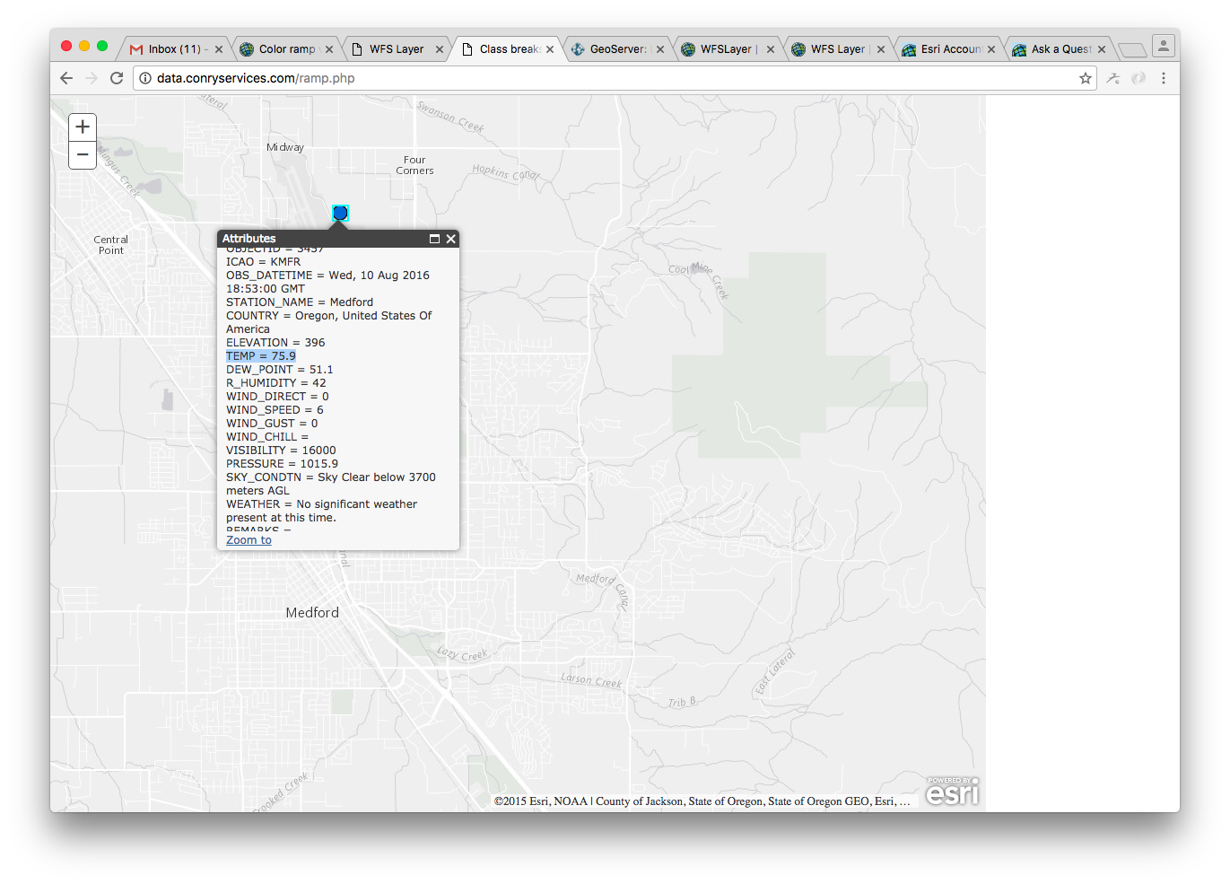

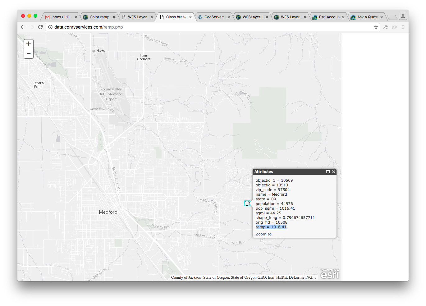

I am trying to implement the setRenderer method of the WFS Layer object using a simple renderer with a color ramp using the setColorInfo method of the SimpleRenderer class. This works fine if I use a feature layer derived from and ArcServer instance, as in this example: Color ramp with rotation and proportional symbols | ArcGIS API for JavaScript 3.17  but does not work for my WFS. Oddly, if I use a class breaks renderer to achieve a similar effect, it works fine. I have found nothing in the docs to suggest that only some renderers work with a WFS. I have isolated the problem with the following code:

In addition I have attached screenshot of the two use cases. If there is any further information I can provide please let me know. Have been working on this for some time and it's quite frustrating.Screen Shot 2016-08-10 at 3.54.14 PM.pngScreen Shot 2016-08-10 at 3.54.42 PM.png
