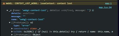

I know this thread is almost 5 years old, but I'm getting this issue too in
4.31.6
I'm able to catch this error here:
Is there a way to restart webgl?
