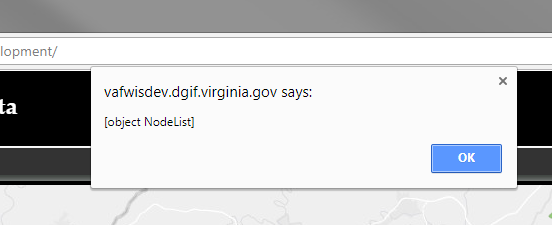

jaykapalczynski
Honored Contributor
If I alert here
var radiodistance = document.getElementsByName('DistanceVS');
alert(radiodistance);
if gives me:
RobertScheitlin__GISP
MVP Emeritus
Jay,
   So the issue is you are returning the dom element and not the value:
var height = document.getElementsByName('HeightVS').value;
