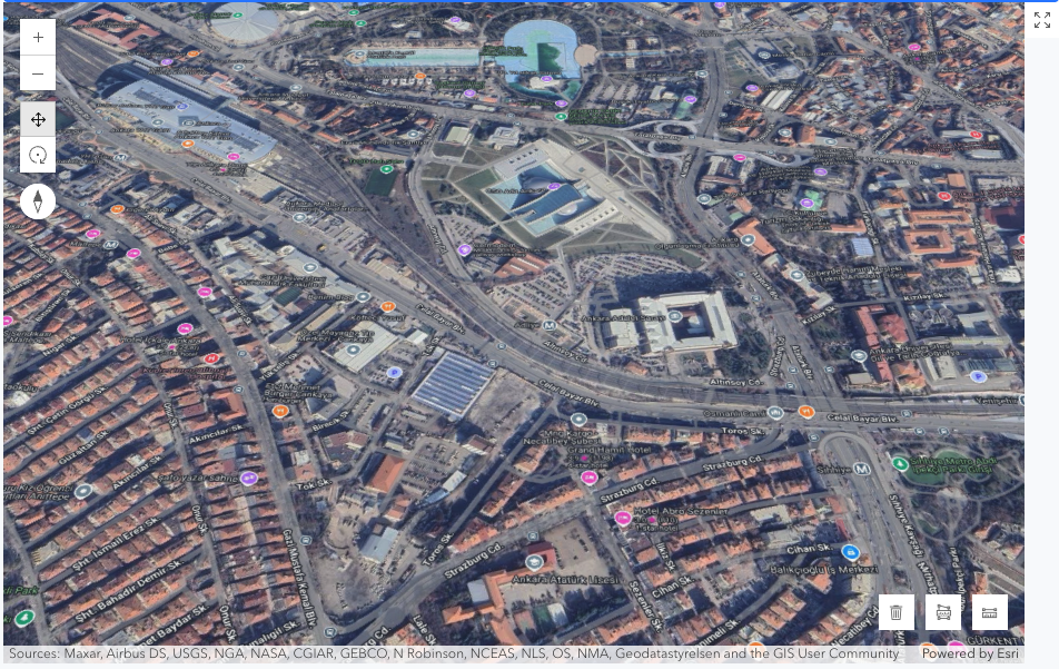

I'm trying to migrate from the deprecated Fullscreen widget to the new <arcgis-fullscreen> web component in my React app (using SDK 4.32+), but hitting a wall. The button shows up but stays disabled - no errors, just doesn't respond to clicks.
What Fails in React:
return (
  <div className="w-full h-full relative" ref={containerRef}>
    <arcgis-map
      className="w-full h-full"
      ref={mapDiv}
      <arcgis-fullscreen
        position="bottom-right"
      ></arcgis-fullscreen>
    </arcgis-map>
  </div>
As you can see in the picture, the button is outside the element and is disabled.
Symptoms:
  • Button appears but looks disabled (grayed out)
  • No console errors
  • No view property warnings
How are React devs supposed to connect the view to web components? The docs show vanilla JS examples but React's rendering lifecycle seems to break the expected flow.
Anyone successfully implemented this in React? Is there a secret sauce to wiring up web components with the view instance? Appreciate any tips!

I don't encounter the issues you are seeing, i wonder if there is some kind of lifecycle rendering issue happening? Are you using React 19 and have everything imported?

Like @JonathanDawe_BAS I'm not seeing this behavior either. I modified our React sample to use fullscreen and no issues.

One thing to check, based on your screenshot, it looks like the fullscreen component is outside the arcgis-map component, but not based on your snippet. Make sure you are not using self-closing tags "<arcgis-fullscreen />", this is not valid for Custom Elements and cause issues like this. Also if you're component is outside the arcgis-map component, there is a reference-element attribute you can use to refer to the id or tag name of the arcgis-map component.
EmrahAydemir
Thank you so much for your help, @JonathanDawe_BAS & @ReneRubalcava. I apologize for the late reply due to my other work commitments. After long hours of coding, I sometimes miss simple details. I had used 3dScene and forgot to add
import "@arcgis/map-components/components/arcgis-scene";
Once I included it, everything worked fine, and it’s now running smoothly. Your answers inspired the solution. Thank you very much! I'm familiar with the old component structure of ArcGIS, but Map Components are a different experience for me...
