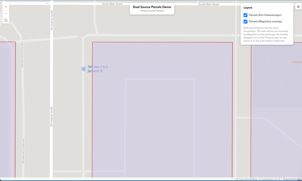

Alignment between Esri and MapLibre parcelsAlignment between Esri and MapLibre parcels

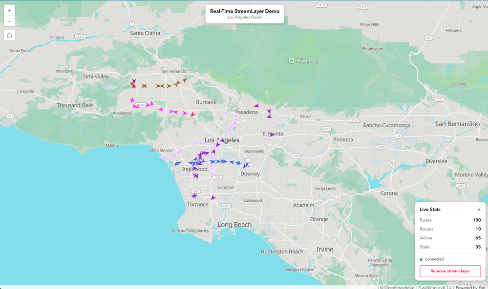

PMTiles basemap with live LA bus feedPMTiles basemap with live LA bus feed
