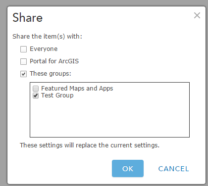

I'm having some pesky problems implementing some authentication for my JS App (which is hosted on an internal web server).  I thought that I could follow the Application login workflow (create application in Portal, use OAuthInfo class with appId to authenticate user to my Portal and gain access to my app) to allow only specific users to access my application as long as I set the security (through Portal) of my Web Mapping Application item to one of my Portal security groups.  Turns out it doesn't matter if the Web Mapping Application is shared with everyone or no one - if my JS web app has the appId, any user can login to my application.

I use a federated / hosted Portal instance on top of my server, so I set the sharing through Portal, not through Manager.  And the service is set to only provide access to members of a group, not all members of the Portal....
