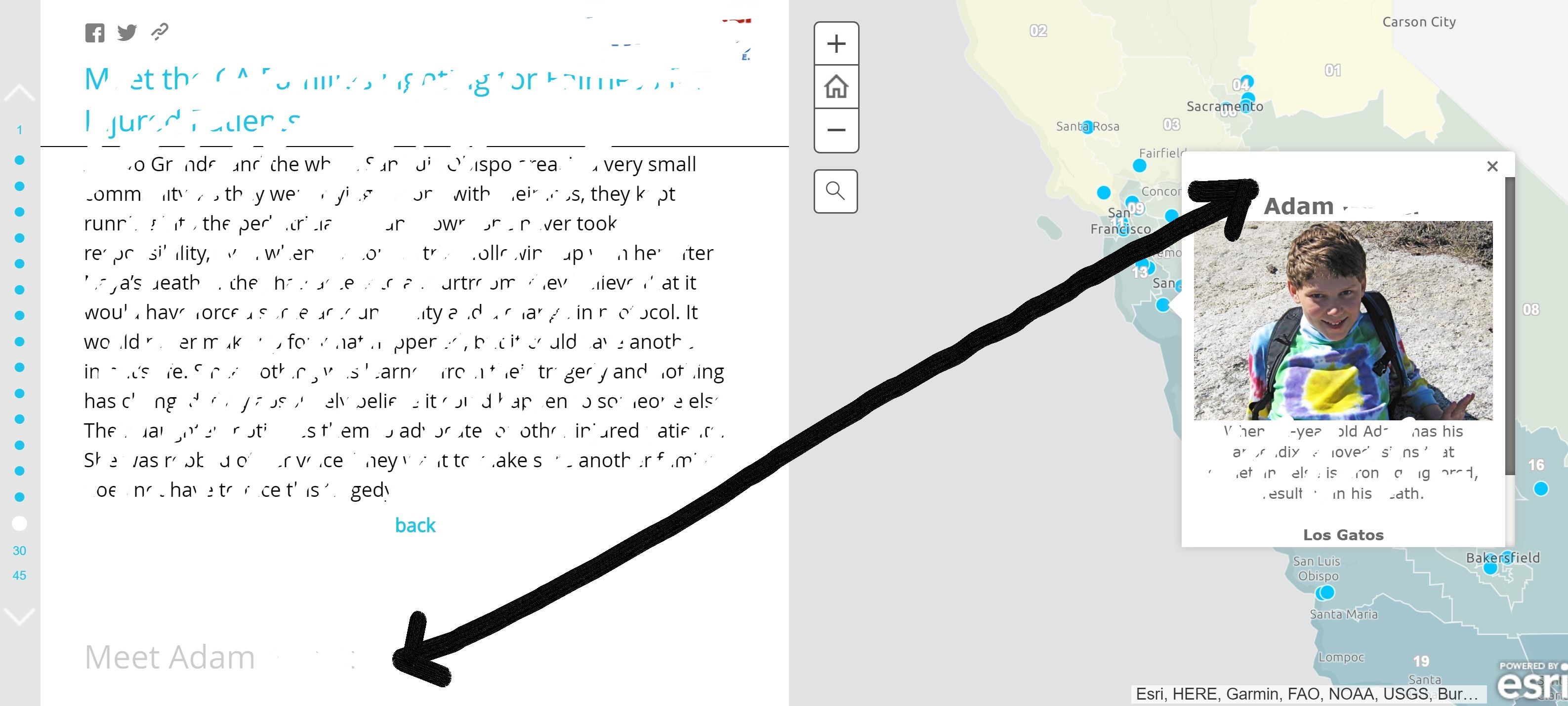

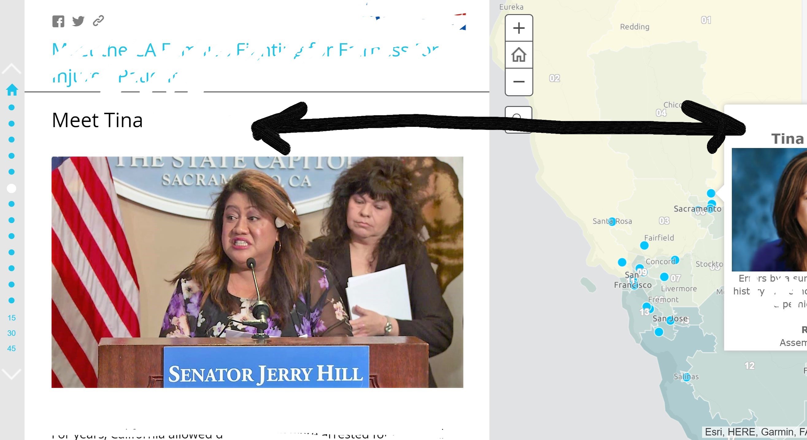

I am hosting a classic story map (map journal style).
I would like to be able to share URLs that link directly to a specific story, which I have successfully done by adding: ?section=  to the end of the map URL
This works for the first 14 to 18 sections (out of 50), but as the story goes on, the URL opens farther and farther from the start of the section in the side panel (the mainstage functions normally and lands in the right spot):
Section 7
Section 30
Does anyone have an idea why the landing progressively changes with links to sections farther down in the story? And any idea how to address the issue?
