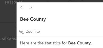

Hello!
I just upgraded a custom app from ArcGIS core 4.30.9 to 4.32.6 and my popup titles seem to have lost their left margin/padding.
Before the update:

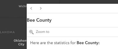

After update:
I am using popupTemplates to create them like so:
popupTemplate.title = "{cnty_nm} County"
I have it docked in the top right corner of the map but undocking it doesn't make a difference.
Did I miss a change in the documentation? Or is there a way to manually move the title a bit and give it some breathing room on the left?
Thank you for any help!

Do you have a reproducible sample? This looks like you may need to update your calcite version as well.
4.32 uses 3.0.3 of calcite
https://developers.arcgis.com/javascript/latest/release-notes/#additional-packages
