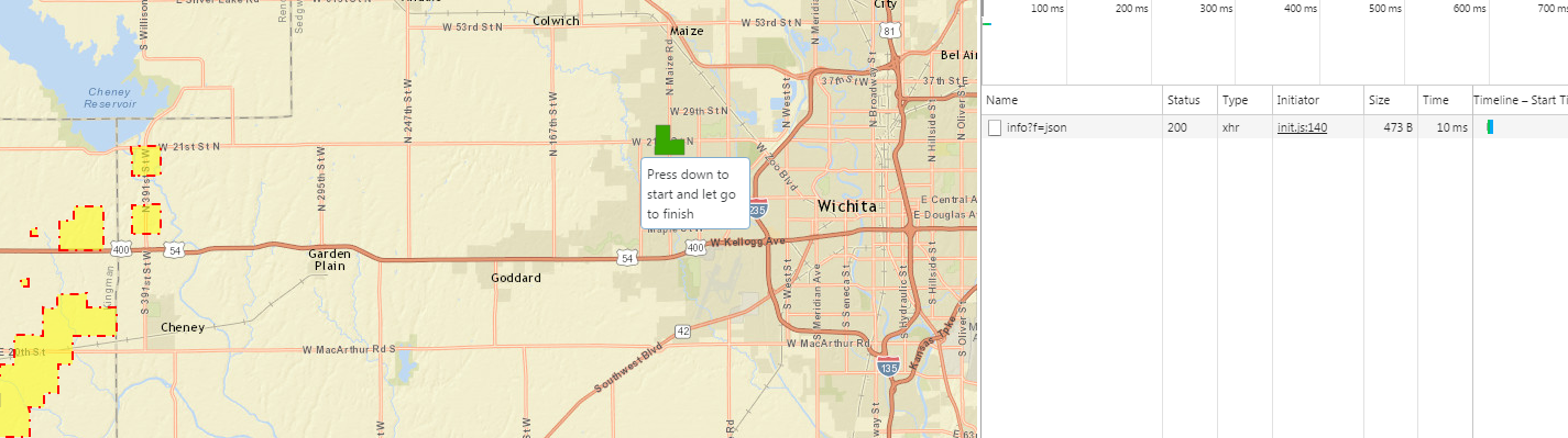

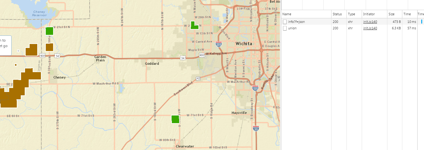

To add to this it seems like
This part is executed correctly, I get my selected fatures and array:
var geometryService = new GeometryService("http://itas46:6080/arcgis/rest/services/Utilities/Geometry/GeometryServer");
                      selectQuery.geometry = geometry;
                      featureLayer.selectFeatures(selectQuery, FeatureLayer.SELECTION_NEW, lang.hitch(this, function (targetGeometry) {
                          targetGeometry = graphicsUtils.getGeometries(featureLayer.getSelectedFeatures());
                          console.log(targetGeometry);
This part does not trigger until the second draw (i dont get any console.log stuff the 1st time i draw and nothing shows up):
geometryService.union(targetGeometry, function (geometry) {
                              featureLayer.clearSelection();
                              var symbol = new SimpleFillSymbol("none", new SimpleLineSymbol("solid", new Color([255, 255, 255]), 2), new Color([255, 255, 255, 0.25]));
                              var graphic = new Graphic(geometry, symbol);
                              map.graphics.add(graphic);
 the first time it looks like this:
The second time it looks like this (FYI you can see on the right window that the union has been successful):

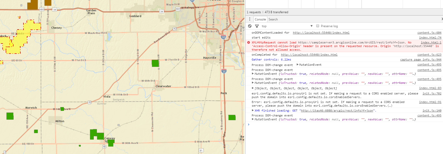

by Anonymous User
Not applicable
Still No errors (except the XMLHTTPRequest, is that the problem maybe?)
by Anonymous User
Not applicable
That was the issue. Proxy was.
