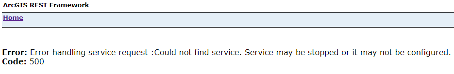

I also tried the service URL individually, I the service shows as follows.

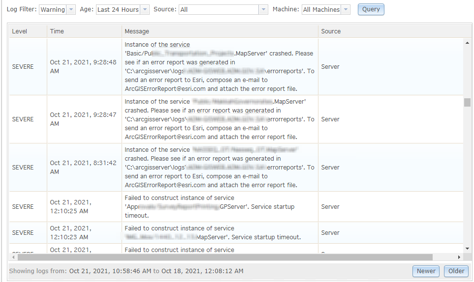

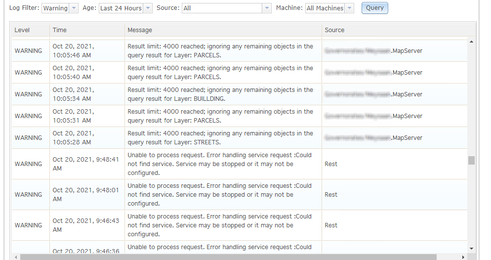

 Below I have provided some log and service configuration screens shot to give some insight.
Yesterday after restarting the "ArcGIS Server" service:

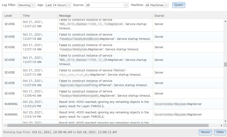

Midnight time log of server:

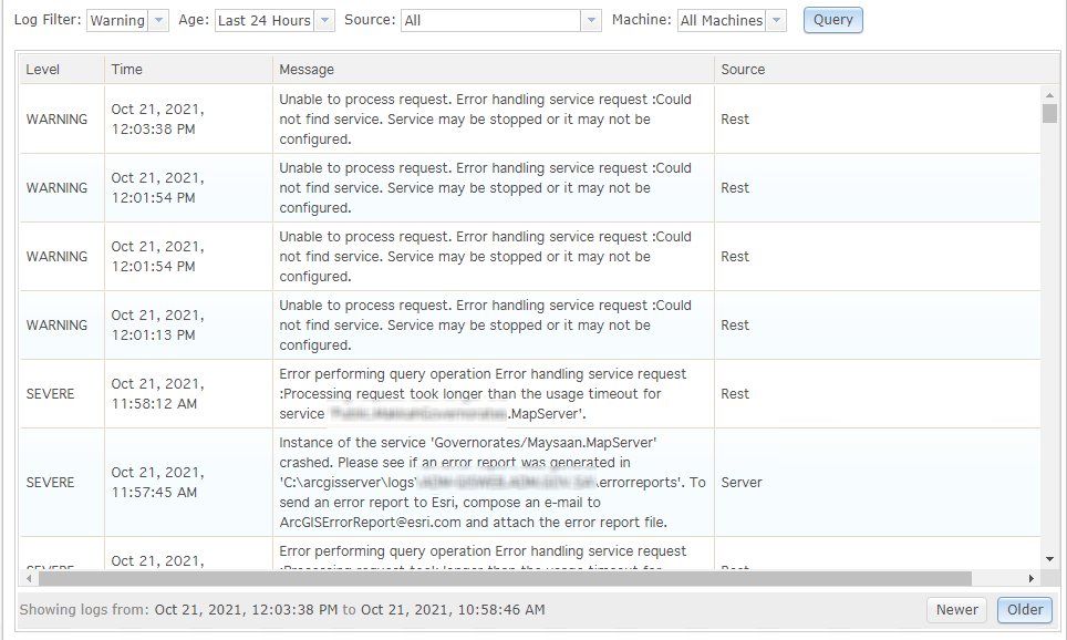

Today when the app requested the service:
Today after restarting the "ArcGIS Server" service

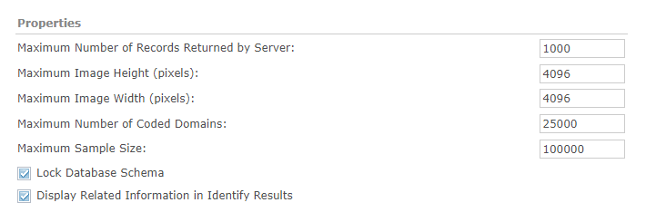

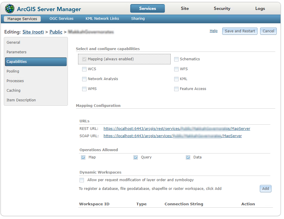

Service parameters are as follows:
 How can I resolve this? @George_Thompson  and @TanuHoque can you also look into this issue.

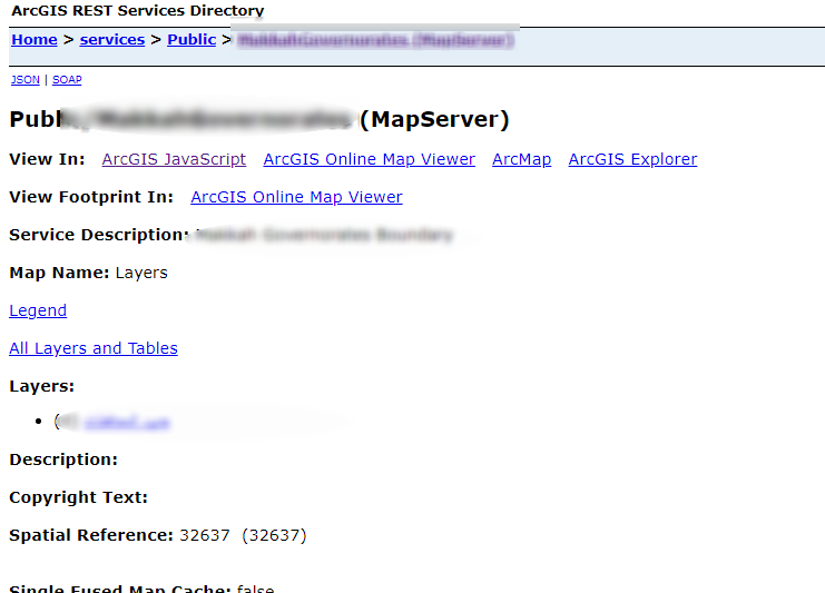

arahman_mdmajid
I am currently able to view all the layers from the built-in JS viewer. All are working normally now but every morning I have to restart ArcGIS Server to achieve this.
