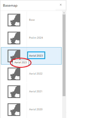

I created a BasemapGallery with LocalBasemapsSource from map service hosted in GIS Server:
const myBasemaps = [
     new TileLayer({
           url: "https://myhost.com/arcgis/rest/services/OCPA/Aerials2023/MapServer"
const basemapGallery = new BasemapGallery({
      view: this.view,
      container: "basemap-gallery",
      source: new LocalBasemapsSource({
            basemaps: myBasemaps
How to setup Tooltips like:
Thanks.

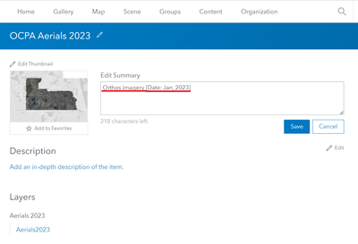

Your LocalBaseMapSource will contain one or more Basemaps. If the Basemap is coming from ArcGIS Online (or ArcGIS Enterprise) then you can edit the tooltip text in your portal: it is the description you give to the item.

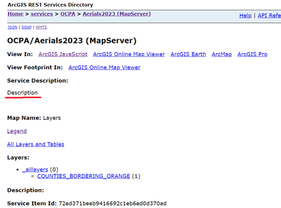

The source of TileLayer is from ArcGIS Server, not from ArcGIS Portal.
How/Where to set a description in ArcGIS Server?

If the source of my TileLayer is from portal and set the summary, then the tooltip works.
I'm wondering if it can be set in code.

Thanks for checking this out. I think it works 'as designed': Esri, of course, wants you to use their portal, and - as you indicate - the summary you set there will appear in the popup.
There is no way, as far as I know, to set this popup text in the code. Can someone from Esri confirm? Code wise, you can only set the title, which will then appear in the popup (like in my code snippet above).
