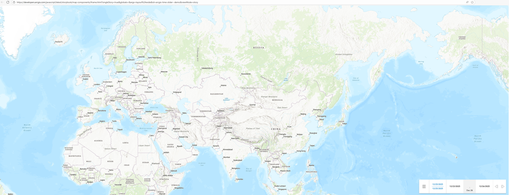

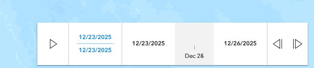

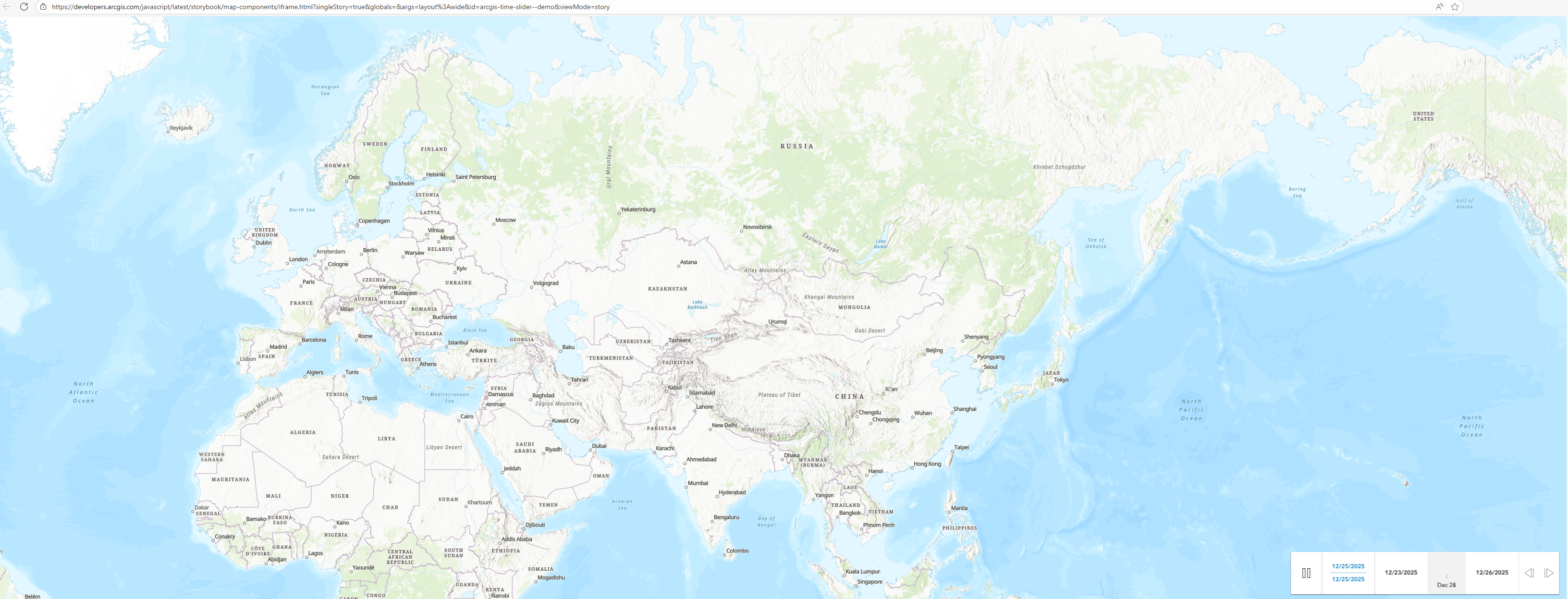

Working with the TimeSlider, I came across the layout property (which is included as part of the demo code).  The 'compact' layout seems to work great on any screen (perhaps, to be expected); however, the 'wide' layout looks terrible on any screen: the 'slider control' gets smushed and you can see the interval-labels render stacked (and this on an ultra-wide screen).
Demo: arcgis-time-slider--demo 'wide' layout.
I can't imagine this is the intended design?
By a similar token, the 'auto' layout never seems to fire either way, so by default we get the nice looking 'compact' layout all the same.

Hi @D_Atkins ,
It looks like the time slider in your screenshots is placed in the bottom-right slot of the map component, which is restricting its width. If you set a relative width on the time slider(or remove it from the slot), it should adjust its layout in ‘auto’ and look much better in a wide layout when not being squeezed into the narrow slot.
https://codepen.io/sagewall/pen/ByzaLMm?editors=1010
