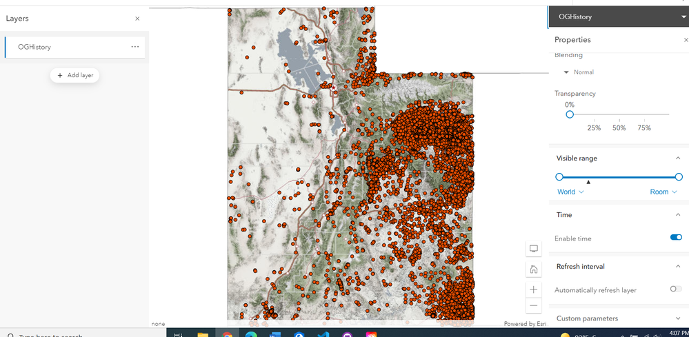

The feature class is set up to be time-aware. That's part of my confusion. If you click on the map link I provided and open the map, the slider exists and works as expected when I hit 'play'.
Here's a picture showing that the time is enabled:
Do you think I need to grab the layer specifically? I have tried doing that, but am struggling with understanding all the parameters in the time slider widget, and I think I can view.when() maybe, but that didn't work when I tried, maybe I got that wrong
