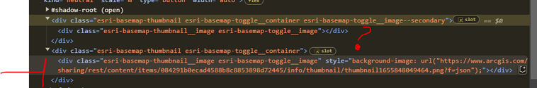

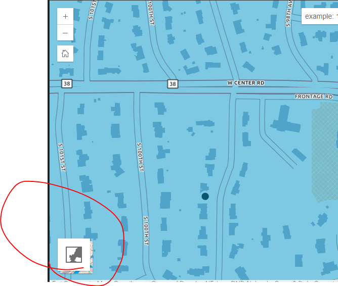

I'm working on a JS Map. I have a webmap, and a basemap toggle added to my 'view'. My webmap uses Community basemap and another basemap that I included in the toggle is 'Hight contrast' basemap. The issue I have is that when I toggle between the basemaps, there is no thumbnail for my Community basemap. And I'm not sure how to add the thumbnail image, since the basemap comes from the webmap?
I would appreciate any suggestions.

NataliyaLys
I got the thumbnail icon to work. For whatever reason it would not work with the Community basemap. But when I used a Topo basemap, it worked. I had to list the basemap update my webmap. I'm not sure if this is the best way to handle this, but it works.

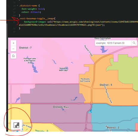

JeffreyThompson2
MVP Frequent Contributor
I've encountered this issue before with a different basemap and fixed it through CSS.
//This should replace the broken image with the Community basemap image.
.esri-basemap-toggle__image {
    background-image: url("https://www.arcgis.com/sharing/rest/content/items/184f5b81589844699ca1e132d007920e/info/thumbnail/thumbnail1659479749621.png?f=json");

NataliyaLys
Hi @JeffreyThompson2 thank you for the suggestion.
I tried your solution, but it still would not work. I see the other thumbnail for the High Contrast Basemap in the dev console, it's loading automatically. But the one that I added in CSS for the Community Basemap is not showing up.
