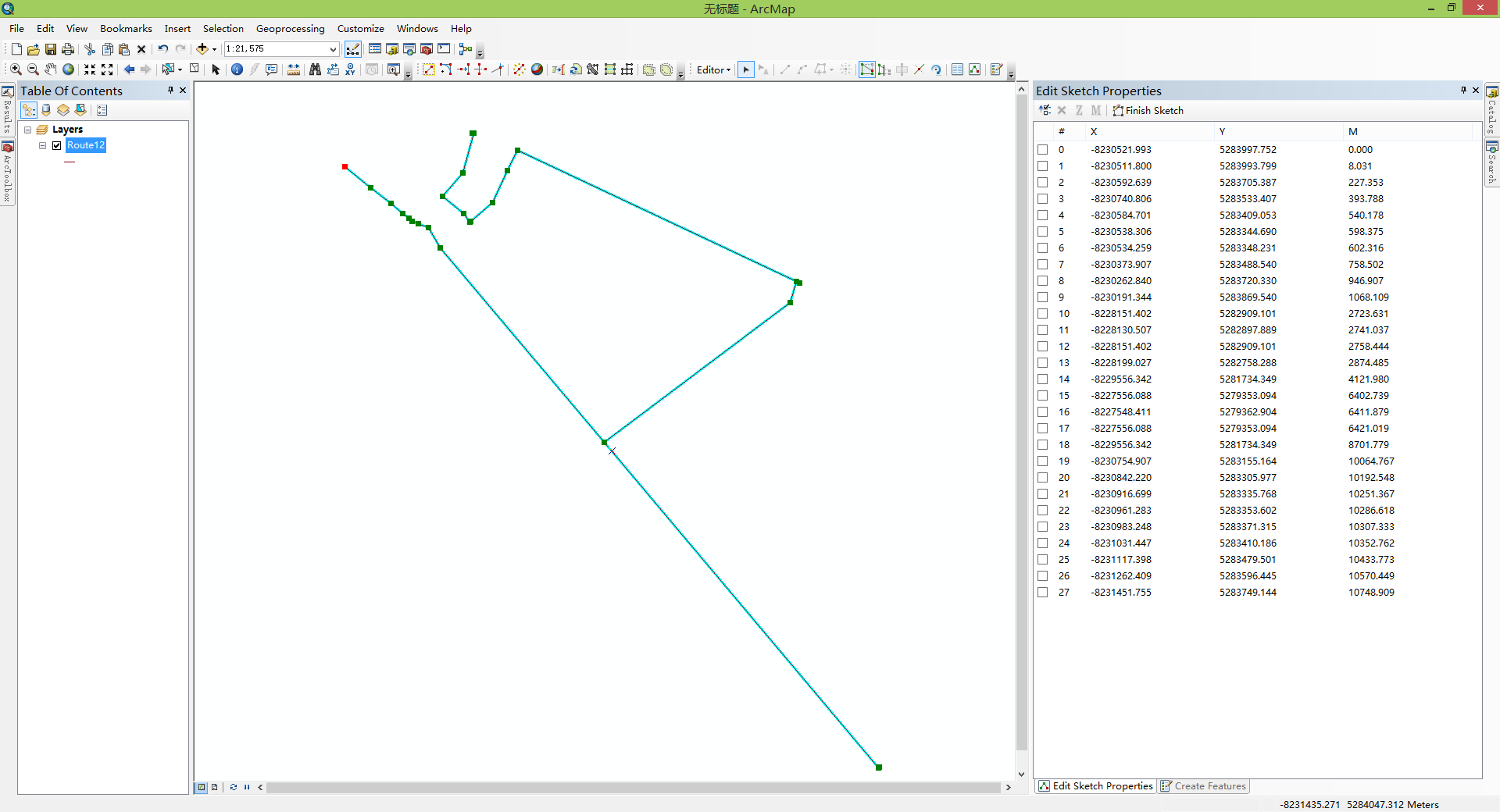

And I confused about the path difference between shapefile and graphics added on the map.
In the arcmap, the polyline has a path with 28 points, while the graphics layer return 3 paths and 20 points.
It seems that my data has been changed. but I can't figout the reason.
The attachment is my data(*.shp) and the scripts, please help me, thanks!

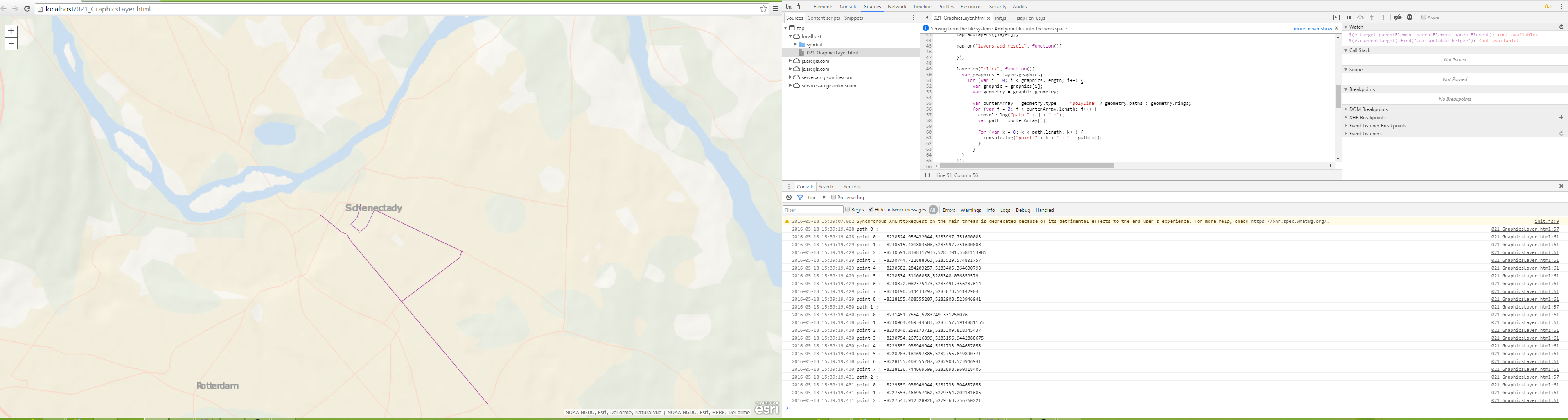

The same question appears while add the RouteResult.route to the feature layer. The polyline geometry also been changed. The results geometry of route only has one path, however the graphic stored has multiple paths. How to solve this problem?

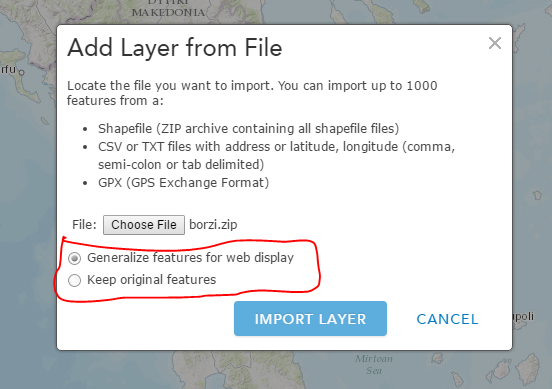

during the upload what did you select for the generalization?
LeoDeng
Hi, ​Panagiotis:
    Where is the "Add Layer from File"? I'm using the arcgis online and using "My Content" --> Add Item  --> From my computer.
LeoDeng
I found it. It's at New map -> Add...
LeoDeng
Using the arcgis online -> New Map -> Add layer from file then save. Finally, I got a published web mapservices. How to get the feature services using original features?

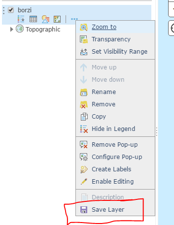

Save the Layer you have uploaded
see item details and Publish this item
after that a hosted feature layer created and you can access the rest end point
