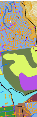

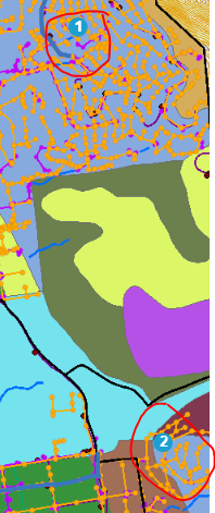

   I am trying to print the text symbol on the map. The textsymbol is available on the map, but when we print it as PDF it's not available. Any idea why it's happening? I am using ArcGIS JavasScript APi  3.26.
The text symbol on map.
Text symbol not available in the print pdf.

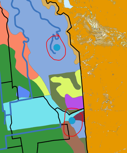

@Noah-Sager I removed the picturemarker symbol and then tried to print it. But the result is still the same.
Print result
