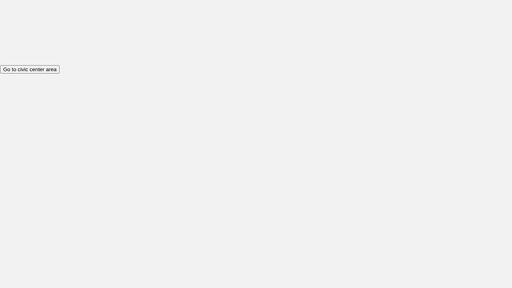

FentonCheng_-_DIT
I did have 'auto-destroy-disabled' set on some of the components, so I removed it. There's only one map on the web page though.
The original is using Angular 20 and ESM; converted the basic functionality over except for one piece that is Angular specific (there's a flag that's used to choose between map and scene). The idea is that the map/scene loads to a preset point, then the user can click a button to go to a new point of interest.
In the Angular version, this line: console.log("button clicked: ", viewElement.suspended) would return true instead of false after the click and the map doesn't load, but the UI (zoom, search) is still there.
https://codepen.io/fentonc/pen/VYevJmX
