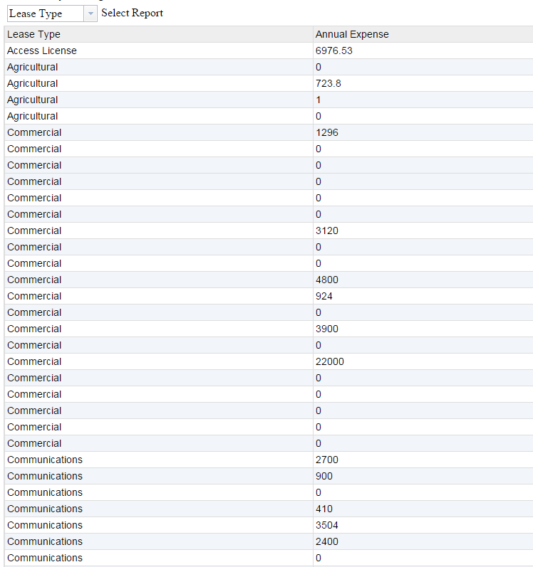

I am creating a dojo grid. I would like to have the grid give me unique values for the Lease Type with the sum in a column next to it. The output looks like this:
I would like it to show one Lease Type with the sum of the Annual Revenue. Here is the code i am using:

  The returnDistinct is just a boolean property to set on the Query class and outStatistics which is an array of StatisticDefinitions. See the documentation links I already provided.
7 Replies

   If you are using ArcGIS Server 10.1 or greater than you can use the outStatistics of Query to supply StatisticDefinition class and also use returnDistinctValues
RobertKirkwood
I looked at those methods but was unclear of how to implement them with the grid. I will do more research and see how to make them work...Thanks!
RobertScheitlin__GISP
MVP Emeritus
Robert,
   The datagrid is just the means you are using to display the Query results. The Query parameters like returnDistinctValues and outStatistics is what will refine the data for being displayed in the grid.
RobertKirkwood
Do i need to redo myQueryTask and replace it with the StatisticDefinition? or is there a place in my code i can implement that? Sorry i am still learning...
MVP Emeritus
Robert,
RobertKirkwood
Thanks! i got the returnDistinct to work. now i will work on the stats...thanks again!
