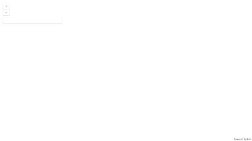

I have a bunch of assets which are MutliLineStrings that are sent to a Stream Layer.  I need to query them using the StreamLayerView and append some of them to a Feature Layer so I can dynamically work with them.  The issue is when I clone the feature from the StreamLayerView, and add it to the Feature Layer, it doesn't show up correctly.  The grey lines are from the StreamLayer, and they are correct.  The red line is the one I cloned from the Layer View, and added to the Feature Layer.

Can you please post the geometry (json representation) that is in question here?

It seems to be a problem with the Feature Layer not redrawing the features, if I zoom in to that area above, and force it to query the layerView, the Feature Layer looks fine. I think when the initial query happens, the geometries are messed up, but get refreshed when zooming in.   When those coloured features are added to the Feature Layer the map extent is rather zoomed out, is there a way to force the Feature Layer to redraw included Features?

Please excuse the delay in response, I can't provide you with access to that data, I was checking if I could.  The to the issue was to run the following, when the view is stationary:
this.featureLayer.applyEdits({
    addFeatures: <new features>,
    deleteFeatures: <current features>,
}).then(function (editResult) {
    console.log(editResult);
    r(null)
Which removes all the current features on the map, and adds them again given the current extent, which causes them to render, resolving the issue.  I guess due to the fully zoomed out extent, the graphics are stored in the Layer View in a rough form, which is why during the query on the Layer View, and then throwing them into the Feature Layer caused the problem I was experiencing.
