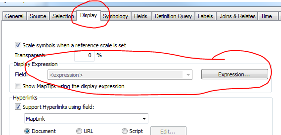

Click on the Display tab for the feature in question.
In the Display Expression area click the Expression button and build an expression.
This is an example of an expression I built for my service meter locations
[BillingFileComplete.ServiceAddress] & " : "&  [ServicePoint.Detail] & " :" & [BillingFileComplete.Name]   &  " : "& [BillingFileComplete.EquipMapLocation]
It will sort results by Service Address, then Name.  pretty much whatever you want
