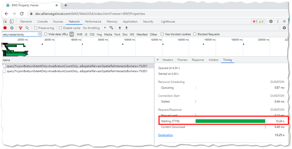

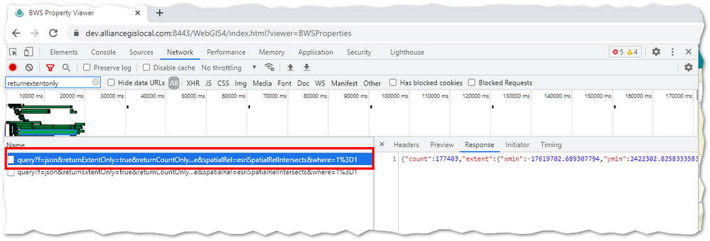

 However, maybe some additional information will help:  The screenshots below show the "returnExtentOnly" request which is issued when snapping is initialized, and this appears to be the request that is causing the slowdown.
The feature count is 177,403 features - which is much lower than the numbers you had tested with.

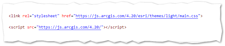

I have confirmed that we are using 4.20:
In our instance, it does seem like snapping is still not operable until the "returnExtent" request is complete.

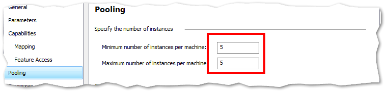

OK, I believe we figured out why our instance was still slow.   We only had a single pooling instance configured for the map service.  So, even though the 4.20 client snapping tool no longer waits for the returnExtentOnly response, it was still unable to get responses from other required requests, because they were being blocked until returnExtentOnly  finished.
We increased the pool instances to 5 for or snapping services, and now snapping seems to initialize much faster.
