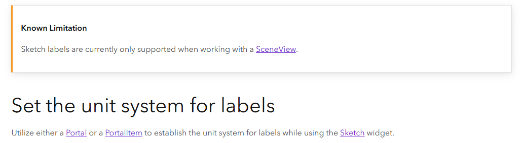

The only unit related option when working with the arcgis-sketch (that I found) is setting the unit system for the labels (labelOptions) via a PortalItem on the Map?
This only works with SceneViews, but we use a MapView.
I could not find any unit options that only apply to the sketch component directly.
