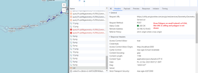

Hello Friends,
We are working on ArcGIS JS API 4.27 and using the import Draw from "@arcgis/core/views/draw/Draw"
to draw polygon but some cases for small Iceland's area of USA it is not drawing polygon, and automatically called this url "https://utility.arcgisonline.com/arcgis/rest/services/Geometry/GeometryServer/cut" which don't know why it is calling, we have not configured it anywhere. Can anyone share workaround to do draw polygon on Iceland's area. @AndyGup @AnneFitz @Sage_Wall

This is the bug in ArcGIS JS API, and it is fixed in ArcGIS JS API 4.28.
