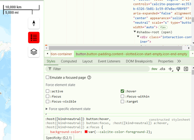

I want my widget buttons to be green by default, and turn red when a cursor hovers over the widget button.
You'd think the following css would do the trick. It did at 4.27:
      .esri-widget--button:hover{
            background-color: red!important;
      .esri-widget{
            background-color: green!important;
Here is a codepen that illustrates the issue. Check out the flashing widget buttons. The map info bar is style because it's an esri-widget:
https://codepen.io/dirkvandervoort/pen/qEWbEBv
Change 4.31to 4.27 in the codepen and you will see what I mean.
Can you help me style my buttons?

I can get hover by setting the calcite var inside the esri-widget class like below:
I am not 100% sure this color will not show up where you will randomly not expect it, depending on how it's used inside and outside the dom:
        /* Start Map Button Styling*/
        /* Overwrite the calcite color system for widgets */
        .esri-widget {
            --calcite-color-foreground-2: red;
You SHOULD be able to set --calcite-color-foreground-3: green; in the same way, but I am seeing "--calcite-color-foreground-3 not defined" in the Developer Tools
ETA: Pretty sure this has to do with the dom changes that I've heard were introduced in 4.28 (we just recently started using 4 so didn't have 4.27).  Since this is inside the dom now, CSS won't permeate it, but the vars are pulled in by ESRI
ColleenDixon
Edit to above, maybe not the shadow-dom issue, but rather additional styling that is more specific than the styling you had.
I was able to get the background color on the non-hover by targeting styling with more specifity:
        .esri-widget--button:is(calcite-button):not(:hover) {
            background-color: green !important;

You can try adjusting some of the calcite css variables. It takes a little inspection to see what variables are used where. But this works.
    .esri-widget--button {
      --calcite-icon-color: white;
      background-color: red;
    .esri-widget--button:hover {
      --calcite-icon-color: blue;
      --calcite-color-foreground-2: green;
https://codepen.io/odoe/pen/JoPGYBB?editors=1000

Pardon my cynicism Rene, but
to change a hover background color?
ReneRubalcava
Esri Frequent Contributor
There's some work being done on calcite and core side for css variables like this, so at some point will be able to get conventions down as intended.
