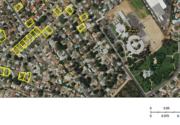

I tried it in the sandbox and it worked for both methods (ArcGIS API for JavaScript Sandbox😞
Here's how it looked without setting opacity:

The second images with the scalebar in the lower right-hand corner is the printout. You can try it yourself, too, in the sandbox - ArcGIS API for JavaScript Sandbox
I didn't make a jsfiddle since it's only a one-line change in the demo.
